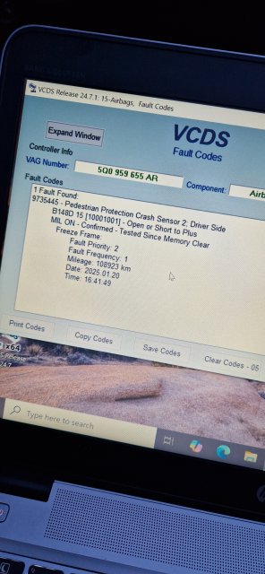

Bought an S3 in November and haven't it on the road just yet with a few issues unknown when purchasing.
Heater Matrix needed replaced as no hot air blowing, took me 5 hrs but got a new one fitted and all good.
Intermittent lumpy idle so i changed the pcv valve and it cured that fault.
Now the last one is an airbag light that came on and I had it scanned with vcds but unsure what sensor it is exactly
Can anyone pinpoint the exact sensor?
Front bumper, drivers door, bonnet sensore etc ... picture attached from vcds
