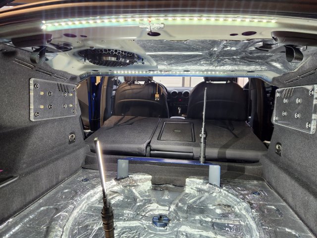

ill need to first take apart the rear liners of the trunk compartment completly to see whats behind there. i wish i was good at video recording and editing to make a documentation of my work on this long project. but i can take photos. if anyone is good at doing videos and is in the OC area it would be awesome to get together and have a fun time at this.
my first step is to take the trunk apart. with the trunk panel out i can then see where i can mount and install any attaching points. i know the size and strength the rack needs to be as these zapco amps are super heavy and long. this makes proper attachment points crucial. my last attempt of this type of rack was done with welding and custom cut frames i designed but in the end it looked really good in my honda. i forgot to mention its going to be an aluminum frame amp rack again. this time i wont be implementing welding but only with bolts and nuts. its going to be something i can do with simple wood working tools to cut and design.

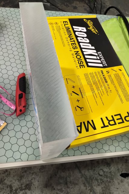

the trunk fram sample materials just arrived today. ill be making some designs with this type of material and start taking measurements once i take the trunk apart. the trunk will take some time as im in the middle of some work.

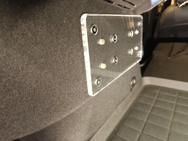

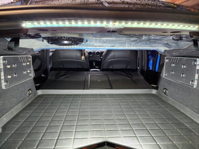

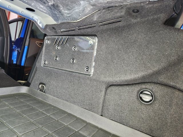

today i did add in some rivenut plus M5. this will give me a point of reference on to where i can do the mounts behind the side panels in the trunk.
in case you don't know what a rivenut plus is, its a way to thread into a sheet of metal or anything similar to that. the difference with a "plus" that its stronger than the other version. being i need it to hold up a very heavy amp and the structural metal frame, it needs to be super strong. this M5 rivenut is the biggest size i can fit and the strongest option available. ill have some pics soon.

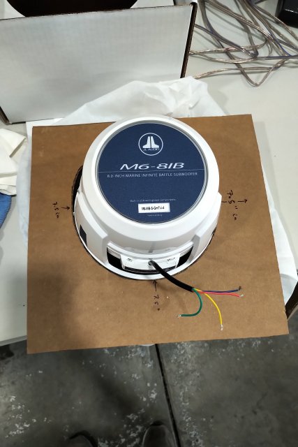

the subwoofer.

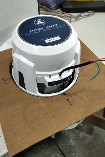

fits perfectly from the top down.
my cardboard template shows that the opening is exactly 7.5inches circular.
the reasons i choose this subwoofer is that it hits all my criteria's.
1. fitment is better than most others with less heavy moding.
2. don't need to cut the current opening in the rear deck. something i don't want to do. it is already considered a weak structure, cutting it would just worsen the problem.
3. quality brand. counting on true RMS within the brand quality, it will help lessen any calculation errors that i may have made.
4. everyone i have read doing this mod, seems to have the issue of not getting the most out of a none enclosure. this is a IB subwoofer, infinite baffle. should lessen the non-box trunk bass problem. ill be testing this out for sure.
but i wont be doing that. lolz
ill be using this here. its not done but you'll see how it works once i have time to get to it.
