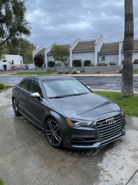

My service advisor stated they blasted the heads with walnut shells then applied a liquid to remove the residual carbon. I have not had a chance to drive at a spirited pace to feel a difference, but the CEL is now off, and the car idles smoothly. With all new coil packs, injectors, spark plugs and the de-carbon process I was billed $2,777.00. I do plan to drive longer distances in 2024 that I am told will help prevent carbon build up in the future. Although, with 45K miles on the clock and now 10 years old I have little to complain about as this was the first big bill from Audi North Scottsdale. IMG_3859.JPG
