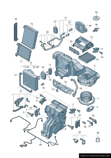

* conclusion, its basically a damaged motor for that flap as well. different flap motor. in the diagram #7 motor.
the system seems to only have a few warning labels; stuck or basic setting set needed.
just state that the motor is not working anymore and needs replacing. it doesn't really mean that the flap is always stuck. the stuck part is saying the motor doesn't work and the flap is not going to move, hence the stuck part of the warning. so fix what ever is making the flap stuck/not moving. could be debris or the motor not working or even an electrical issue.
627
47

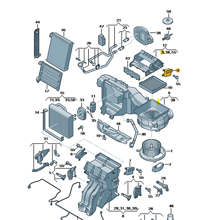

in there diagram, there are 3 locations for 3 different motors. i dont know for sure which one but my guess with the description of the scan, its #3.
but all the motors are; #3,#5, and #4.
the other two seems like its more for the "air mixing" because it opens and closes for the different sides to get different temps per each passenger preference. and not air recirculation.
here is the location. its number 3 with it highlighted.
larger photo diagram

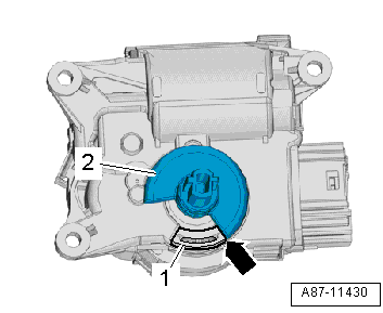

I found the issue. i have attached a link which is for the A3 mk2. ill verify this later as I need to remove the unit again and do the proper installation.
but basically,
the unit needs to be installed in a certain position. the instructions is in this link
https://workshop-manuals.com/audi/a...tiometer_for_air_flow_flap_control_motorg113/
