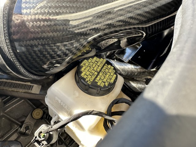

I recently installed wheel spacers and the Eventuri intake for my 8Y. Once I started it up, I immediately noticed the pedals vibrating, almost as if I am feeling the engine through the pedals. This typically stops at higher speeds, and occasionally doesn't even happen at all at any speed. If something was rubbing, why would it randomly stop? I also noticed the engine making a "raspy" noise when I lift up the hood. Any ideas on what the problem could be? I feel that it has to do with the intake more than the spacers.

SOLVED...Hopefully.
Intake is hitting the brake fluid reservoir. The intake also happens to have an indent there for clearance reasons, giving me more of a reason to believe this is the issue.
Will adjust the intake and report back for future solution-seekers.

SOLVED...Hopefully.
Issue officially SOLVED. Fitment just needed a little bit of tinkering. Tight fit!
