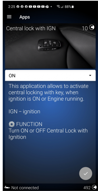

Hello, everyone.
I have a 2020 RS3 and it didn’t come with remote start, which is mind blowing for a 65K vehicle. On cooler days, I tried to start the engine and let it run for a bit to warm up... But the car won’t let me lock the doors so that I can walk away. I’ve tried using the door sensor, the key fob and even tried holding it down for a bit. Nothing that I’ve tried has been able to lock the doors. Every car that I know, you can start the car and lock the doors so that it can be left unattended. Any help would greatly be appreciated.

Older post but I just checked my OBDEleven app and it looks like it has the option that you're after.
Thanks for your reply. I don’t have this app. Is this a
special program or free app. How does it work..?

It's a obdII scan tool that works with your smart phone https://www.ecstuning.com/b-obdeleven-parts/obdeleven-pro-scan-tool/024871obd01~a/
there's a newer version as well for iphones https://www.ecstuning.com/b-obdeleven-parts/obdeleven-pro-pack-next-generation/024871obd02~obd/
Their website https://obdeleven.com/en/
I use it for various things besides scanning and resetting error codes. I've used it to turn off the headlight washers. And allow video to play while driving so my passengers can watch movies. And various other options.
Also handy to release the rear breaks when doing the job yourself and reset oil and maintenance intervals.
Loads of option that you can change with your car.
I haven't tried the next gen one I still use the first gen. It's very simple to use for recoding features you basically just select the option on/off and update the car much easier to use than VCDS.
