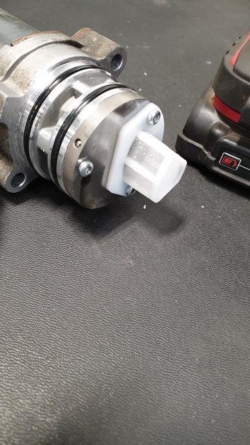

Have you changed your haldex fluid and cleaned the screen? If the screen is clogged you'll lose the rear power or burn out your pump. If your front wheels are breaking loose then there's something definitely wrong in the rear. They can get pretty cruddy if you beat or neglect the maintenance. Pic below is not my car I change and clean mine religiously it's a 10min job.
should look like

Yes man, in my last maintenance I changed the haldex oil and the dsg oil + dsg filter.
As you said the screen was a little dirty, but nothing like the pictures above. It was cleaned during maintenance.
