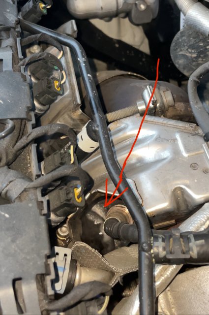

Hi all, just got myself a 2014 S3 and love it, however today it let me down. It has developed a coolant leak, while stopped at junction I noticed steam coming from engine bay, I pulled up and opened the bonnet, the steam appeared to be coming from the back of the engine, I took off the plastic cover and found the coolant bubbling (see attached video). I read all the threads on here regarding water pump failure but that would mean a leak from the bottom of the engine not where I’m seeing it. Has anyone else seen this?
