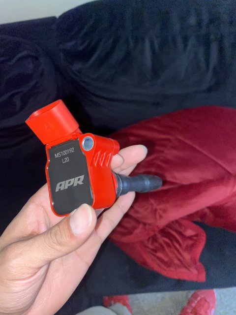

Anyone have any suggestions on removing my coil packs for a spark plug change? Only one of them came out like nothing? currently at 65k miles

Yea from what i saw online i’m just going to have 2 rip em off so i got these as replacements since they’ll probably rip

the method im mentioning is basically going to damage the bottom section of the coil pack. its rare youll be able to save the boot section.
the coil packs are a 2 piece unit. the bottom long stem rubber section and the square top.
remove the top. they come of with some persuasion. its like a boot. once off you take out the inner spring.
add in some wd40 and let sit for a few mins. work on the next.
go back at the end of the row.
use a long skinny pick with a small blunt tip.
push down the hole with wd40 oil.
go up and down, all around the spark plug on the inside of the boot.
after a nice go around youll be able to pull up the boot.
the boot can be damaged as you should be able to buy a new set but keep the top coil pack to reuse.
