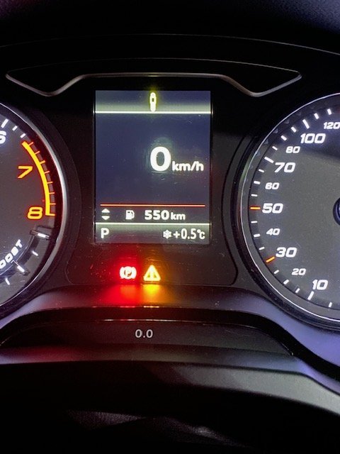

Hi Everyone,
I am new to the forum and looking for some help.
I have a suspension system fault error code and don't know what it could be.
I have been driving with the error on for about 1-2 months and haven't noticed any changes. Has anyone experienced something similar and have any suggestions on what it could be?
Thanks in advance!

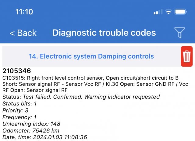

I was able to get my hands on a OBD II scanner and the following code (C103515) came up.
It seems to be a ride height level control sensor.
I will look into buying a new one and replacing it. I will keep you posted :)

Update: Bought new part, replaced it and now no error code! :)
I created a quick document to show the issue and how it was fixed. Hopefully it can help anyone else having the same issue/code.
