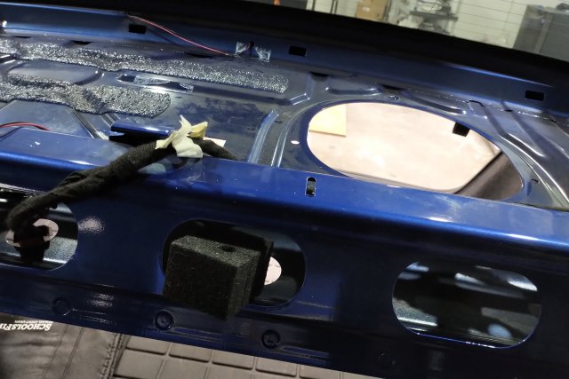

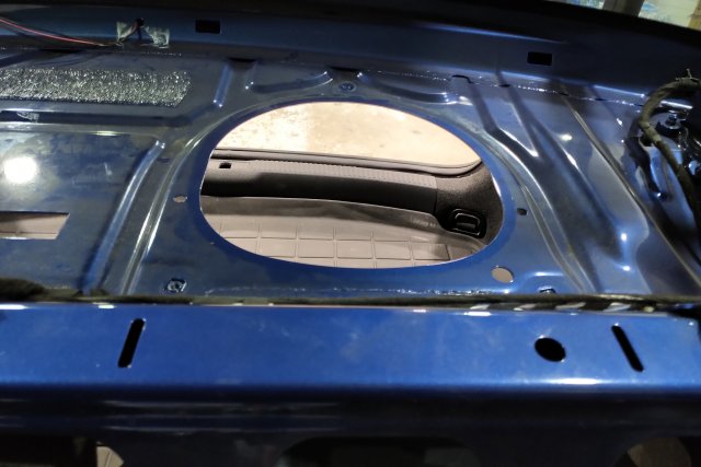

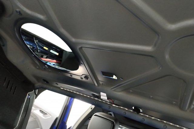

i have had the rear deck open for about a year now. just have not had time to do anything.
with measurements the hole is not a perfect circle. at the smallest diameter it is about 7.5inches. so an 8.0inch subwoofer will fit. but with some cutting and molesting the hole, you can make a 10inch subwoofer fit as well. i personally am trying to keep the car in original form. i don't think ill be cutting it open more to make it a 10 inch. i know the added diameter will be worth it but im not really into cutting at this point. maybe down the road. that way it will give me another reason to upgrade again. lolz

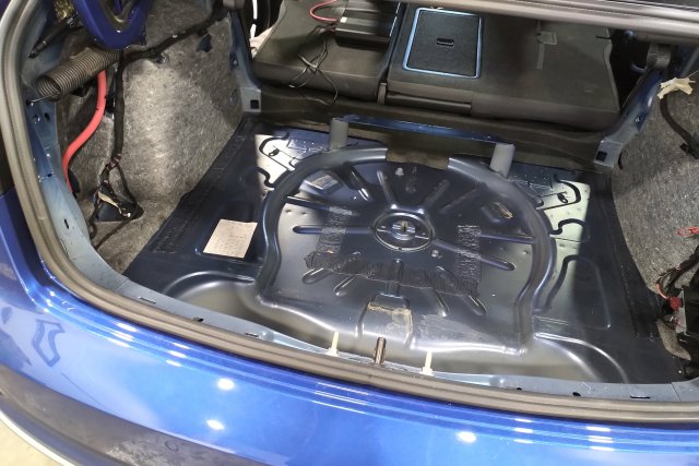

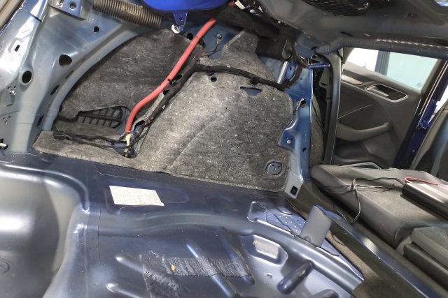

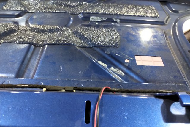

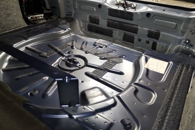

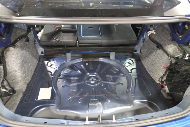

just took out most of the rear liners and bit and pieces.
after this, ill need to clean it up. before a full treatment.

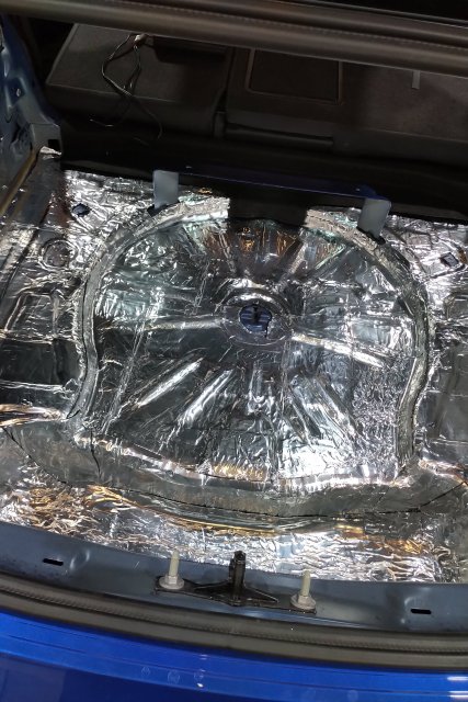

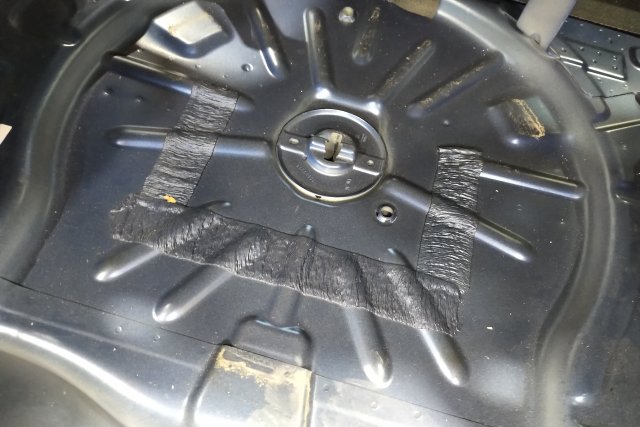

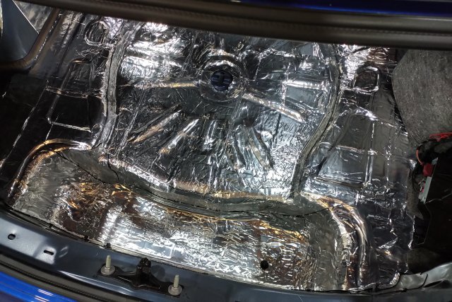

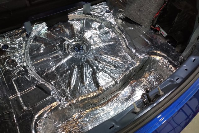

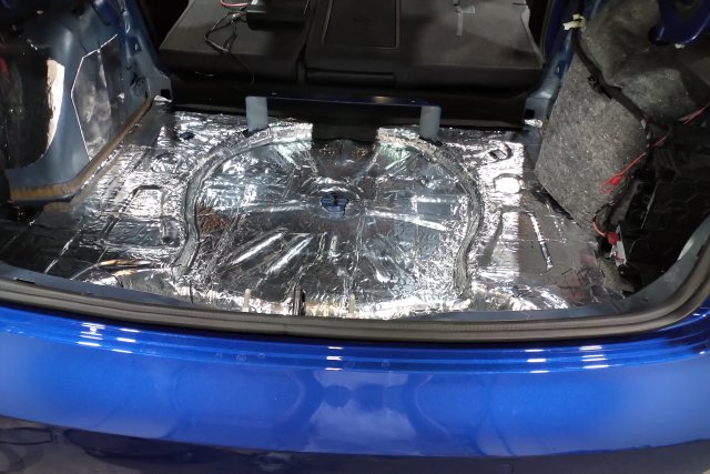

just finished the trunk.
here is a photo of the roller tool i used.
tomorrow will be the rear deck. to much work to finish in a day both sections. lolz :cry:
i hope you guys likey. ;) :p

one of the things i noticed about the tire well, it is super hollow. it really needs this process.
since im in southern cali, the heat is really strong during the summer.
when i leave something in the trunk i noticed that it gets really warm. so if its groceries, it will spoil the food fast before i get home during the summer drive. this product is supposed to make another barrier for any heat transfers. whats weird is that the bottom of the trunks must be really hot. because between that tire well, is the tire, then some foam, then carpet. and the trunk can still get warm. i feel its partly the exhaust heating up the bottom of the trunk.
so ill give a report back with our expected heat wave for this summer.

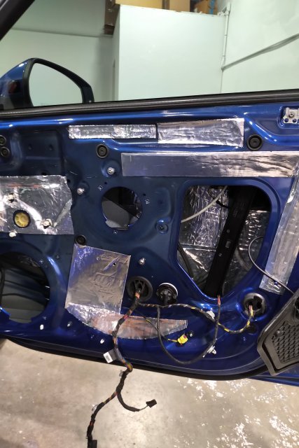

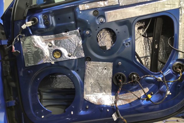

here is the door. just finishing up the passenger door. the idea with the door is that i didnt want to cover up the screw holes are at. and i plan on doing a bracket to upgrade the speakers down the road. so didn't care to do those as of now. they will be more covered once i upgrade. but the usual rule of thumb is, 25% is the key amount to be covered for optimum deadening. anything else will be have a diminishing effect for your efforts. ill see how it sounds after a month of use.
